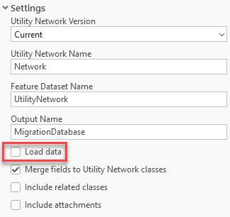

The first step to creating a repeatable migration is to run the migration tool with the Load data parameter unchecked. (it is checked by default). This will create a data model (referred to in this article as a template) and a data loading workspace containing data mappings that can be used to remigrate your data. You can then keep a copy of this empty database to use for data loading purposes.
Run the Migrate To Utility Network tool with the load data option unchecked to create an empty geodatabase with your schema.Run the Migrate To Utility Network tool with the load data option unchecked to create an empty geodatabase with your schema.

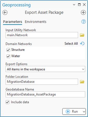

This is a powerful approach, but how does it apply to the migration toolset? The Utility Network Package toolbox contains a tool that allows you to export an existing utility network with all its configurations to a new asset package. This means that, once you reach the end of a prototype/pilot phase using a model that was created with the Migrate To Utility Network tool, you can use the Export Asset Package tool to turn it into an asset package for re-use in subsequent migrations.
Use the Export Asset Package tool to turn your utility network into an Asset Package you can use to create a repeatable data migration.Use the Export Asset Package tool to turn your utility network into an Asset Package you can use to create a repeatable data migration.
  Once you’ve exported your utility network configuration to an asset package, you then need to update the data loading workspace to point to the new asset package. This approach allows you to adjust the model, reload data to the asset package using the Data Loading toolset, and use the Asset Package to Geodatabase tool to deploy the asset package to a new utility network.
