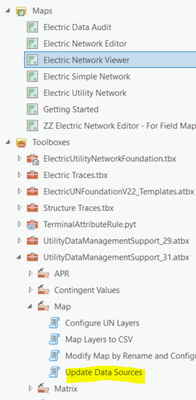

MichaelHirschheimer
Hi @lorenzoz,
There is a python toolbox, Utility Data Management Support tools, that contains a GP Tool called:  Update Data Sources.  I've been using that GP Tool to resource the Electric Network Editor map and others to a Featureservice.
The Utility Data Management Support tools toolbox is part of the latest Electric Utility Network Foundation package (v2.2).
If you aren't using the foundational package, the toolbox can be downloaded from here
help doc for this GP tool.
Also, there is a Pro 2.9 and Pro 3.1 version of this python toolbox.
Hope this helps!
Mike
lorenzoz
Thank you @MichaelHirschheimer!
Using the GP tool in the pyt toolbox actually worked! I correctly referenced the Editor and Viewer Maps with the service already published, then I published the Editor and Viewer Web Maps in order to see them in a web environment.

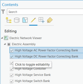

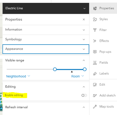

I only have a doubt.. I published the Viewer Map, but the service is still editable, I think because it references the same service as the Editor map.
Do I have to reference the Map Image Layer on the Viewer Map? Or there's a possibility to limiti editing of the Feature Service only in that web map?
Thank you for your help!
Lorenzo
MichaelHirschheimer
Hi @lorenzoz,
You can toggle the "editability" of each layer in the web map.  This could be in done in ArcGIS Pro
or in the ArcGIS Enterprise Portal's Map Viewer.
