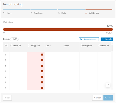

Sorry for the delayed response and thank you for sharing this with me, it does partially address another issue I was having with displaying information from layers in ArcGIS. Is there a way for me to run analyses like queries or site suitability analyses with the information on context layers?
Also, how can I make sure that the built-in zoning attributes are captured and displayed appropriately when I upload them from a feature layer? I tried to create another urban model and it required some sort of "zone type ID" and other information that I didn't need to use initially. Below is a snip of what happens when I try to upload zoning from a feature layer now:
Is it correct, that you are importing zoning from a feature layer symbology when you create a new Urban model? In this case, you need to make sure that all zoning boundaries (polygons) in your data are symbolized (colored) according to a common ZoneTypeID. Could it be, that this is missing for some of the polygons in your case? Feel free to write me a private message, I am happy to have a look at your data to see what's wrong.
As an alternative, you can consider creating the Urban model without any zoning first, and adding zoning later in the data manager. Learn more in our documentation about the options.
