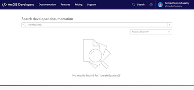

Regarding API I do read the documentation and did some search, and I could not find ant .createSpaces()

The queries and mutations that the API provides are all documented in the GraphiQL page. On this page, you can explore and try different Urban API calls. Click on the little book at the upper left corner to open the documentation of each query & mutation. If you search there for "createSpaces", you will find more information about this mutation. Similarly, there exists a "createParcels" mutation and much more.
