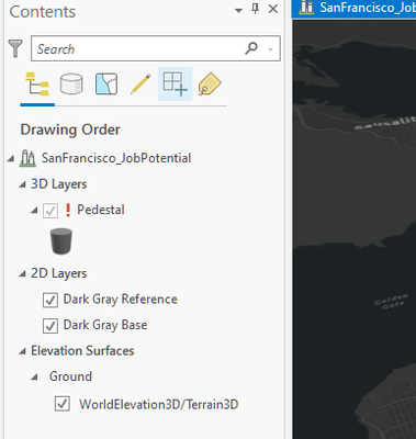

The Business_Data_by_Industry file seems to be missing the industry data.

I can't reproduce this problem. It's possible that something got disconnected with the map package.
The data is stored inside of the Scenario3_PredictedJobGrowth.mpkx file, but once you open this package it creates a new folder. You'll probably need to delete this folder to fix things.
I recommend these steps:
1. close ArcGIS Pro.
2. Go to C:\Users\<your user name>\Documents\ArcGIS\Packages and delete the Scenario3_PredictedJobGrowth_d0e233 folder.
3. Delete the folder you downloaded for the lesson.
4. Start the lesson again, re-downloading the data.
I hope this resolves the problem!
