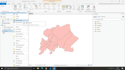

deddysetiawan
If you are using ArcGIS Pro
Right click your layer -> Atribute Table or just using shortcut by clicking CTRL + T

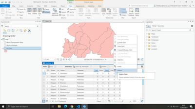

Choose your field that you want to delete by clicking Shift or CTRL on the title of each field
Right click the last field that you has choose -> Delete
