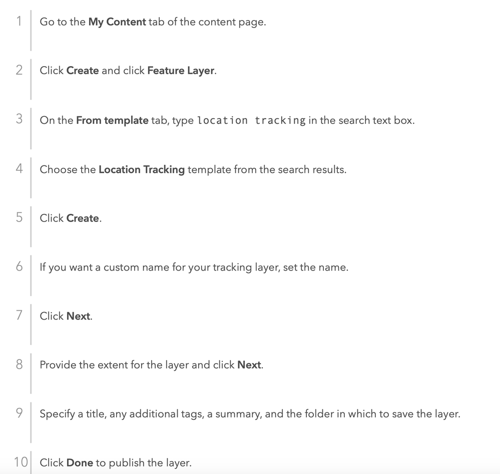

However when I try to create a feature layer, so I can use the tracks and location services on other maps, apps, etc, I can't seem to connect the tracking data to the layer... I followed the directions, specifically:

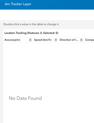

But when I look at the layer, I don't see the data:
-and obviously when I add the layer to the map, I dont see the location of the iPhones... I feel like Im missing out on the part where you can connect the feature layer to the data...

I think there is some confusion here. The instructions you linked to only apply for Collector Classic. They do not apply  for Tracker, Collector, or Field Maps.
You mentioned that you are able to view tracks using Track Viewer, in order to do that you must have created a Track View. This is a feature layer view that the administrator owns. This can be shared with other users either through Track Viewer or through ArcGIS Online. Any user that needs to view other peoples tracks, needs to have the "view location tracks" privilege added to their role.
You can add the track view layers to any other maps and use them in apps like ArcGIS Dashboards and Web App Builder.

After you create the track view, it will appear as a feature layer item in your (the owner of the location tracking service) content. Then you can add that to a new map.
Then use that map in a dashboard. It's highly recommended to apply a relative date filter in the map prior to adding it to the dashboard.
There is no need to use the Location Tracking Template.
