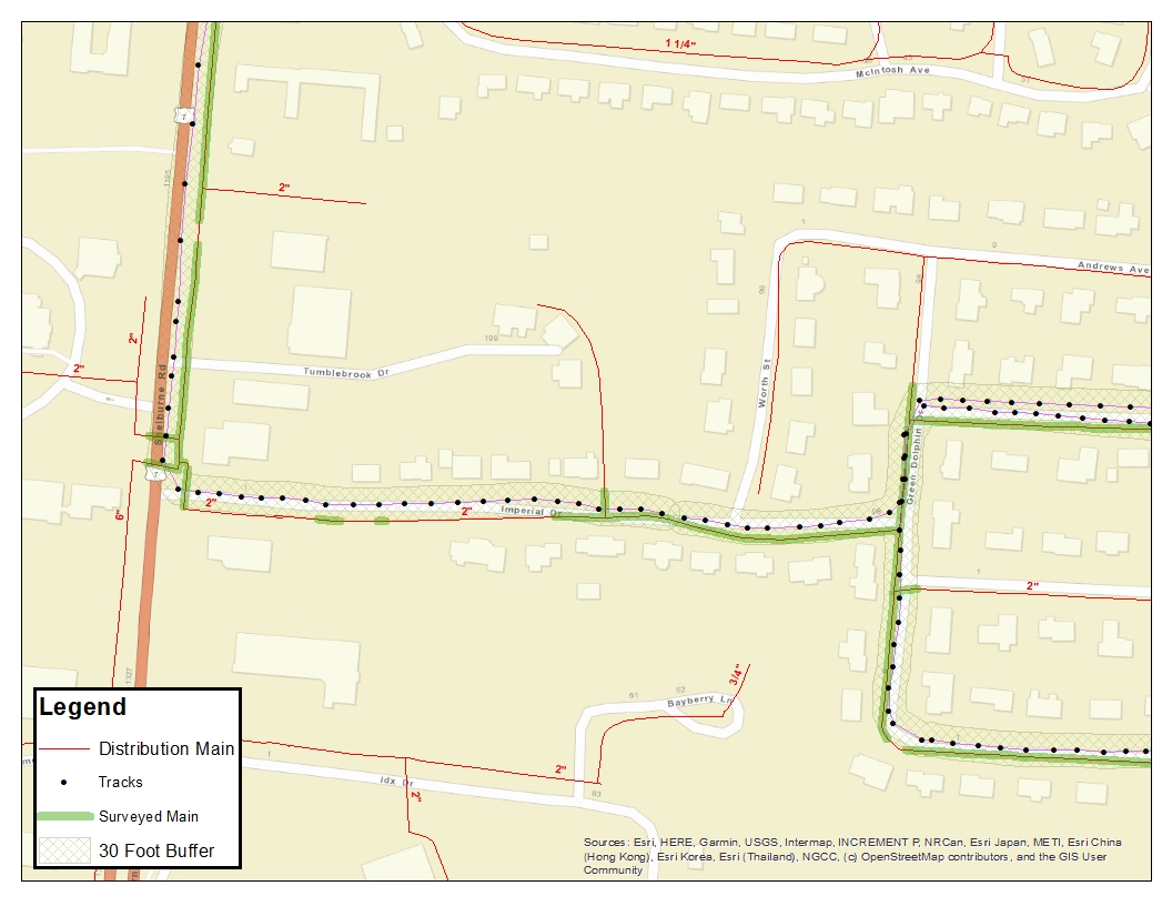

JamesCunningham5
I haven't seen an option to change 'provider' like in collector. Is there some documentation for this?
We are using tablets to provide our gas assets to field crews conducting leak surveys. (for years they have been highlighting paper maps to prove compliance with leak survey standards). I'm using the tracker app and the breadcrumb feature class it produces as our record of leak survey. Using the points, we're creating a line and a buffer to select the pipe they surveyed and calculate the distance of that pipe.
Having higher accuracy GPS info would limit the size of the buffer needed to encapsulate all of the pipe the users truly did survey. Some corners and small gaps exist that I think a better GPS would fix.
by Anonymous User
Not applicable
Since Tracker doesn't support reading the metadata you do not need to explicitly choose a provider. If your device is paired with an external receiver, the internal location manager of the operating system will automatically receive those high-accuracy locations and forward them on to apps like Tracker. The only caveat is that at least on iOS the best accuracy that will be reported is 5 meters, even if the actual location is more accurate. So basically it will "just work".
