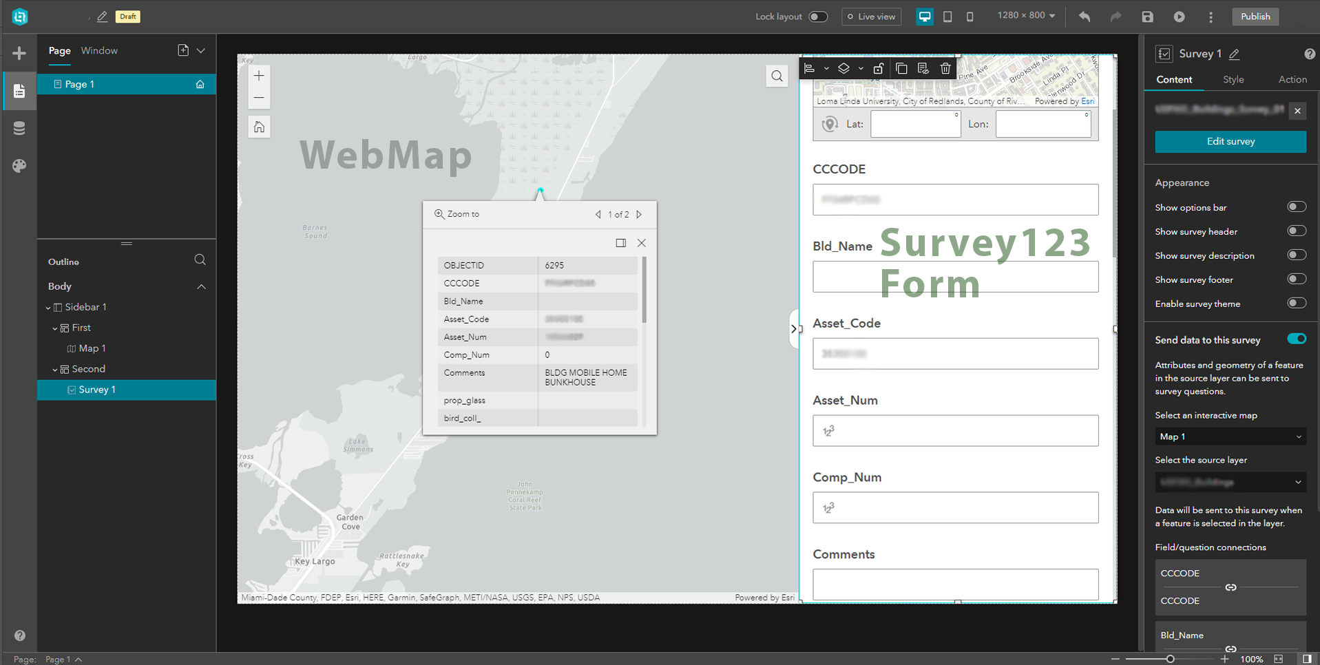

Hello Community,
I created a Survey123 form from an exiting AGOL  feature service (using Survey123 connect-see pic). The intent was to use the survey123 form inside experience builder to update the attributes on the existing feature service. I can capture the attributes from the map to the embedded survey using the experience builder tools "Add Connection", however when I submit the survey,  it juts create another record (a duplicate) on the attribute table. What I need is  to update the existing selected record, populate the fields that are blank and update the map symbology (e.g., red dot to green). Does anyone now what I'm doing wrong or have any suggestion how I can accomplish this task??? Thanks!

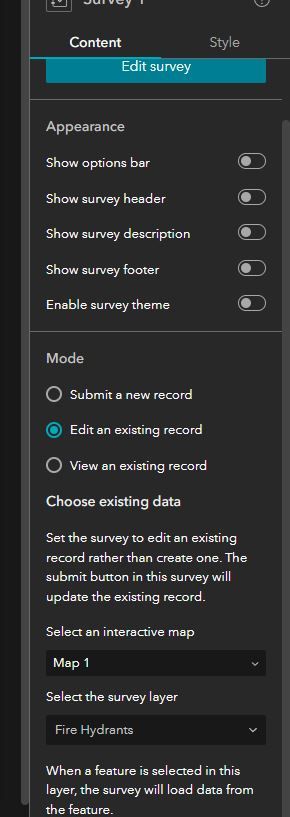

Using Survey123 in experience builder to edit the items on a map. As long at the map contains the Survey123 layer and the globalID then using edit existing record should work. You will have to select the item on the map to pass through data to the Survey123 and the Survey123 will need to contain all the original fields and the empty fields as well. Capture123.JPG

Add the survey layer to your webmap, then in your survey widget settings (see screenshot above), select the survey layer from the dropdown - this will establish the connection using the GlobalID parameter and your issue is solved.
Tip: consider disabling the popup for this layer in the webmap, I personally find that distracting after clicking on the map, the survey is being populate already and that's sufficient feedback IMO.

Hi @JoseBarrios1 ,
As this concerns The Survey123 Widget in Experience Builder, this should be addressed in the Experience Builder community.  That being said, what you are seeing is the current design of the Experience Builder Widget - it supports the collection of new data only.  You can use the Embed widget in the same fashion that @JamieLambert mentions configuring Survey123 in a dashboard.

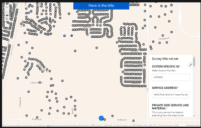

cmerwin
Mr. Fisher,
Do you know if I can set this survey to appear ONLY when the user selects one of the points (features) Instead of it always taking up space on the map?
Any insight you can provide would be greatly appreciated!
