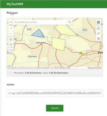

We have a very simple Javascript script that takes a polygon (geoshape) and checks for overlaps with existing polygons in a hosted feature service. We can successfully run the script in Survey123 Connect, but when the Form is published the results for overlapping checks fail. After digging into the issue, it became evident that the geometry format is different with swapped Lon and Lat coordinates when compared between Survey123 Connect and Web App.

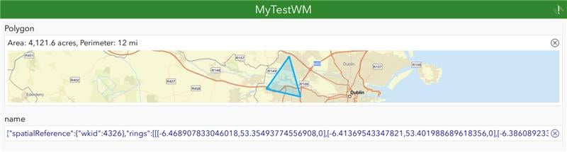

Survey123 Connect which is working and as you can see the WGS84 coordinates are in Lon (X), Lat (Y) and with Spatial Reference property included:

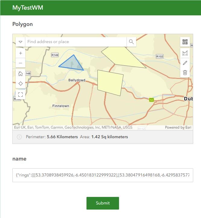

 On the other hand exactly the same script running in the Survey123 Web App returns a differently formatted JSON of the geometry where Lon and Lat are swapped and no Spatial Reference defined.
Has anyone encountered this before and what was the fix for this? Are there any properties I can set for Geoshape in the XLS form?
