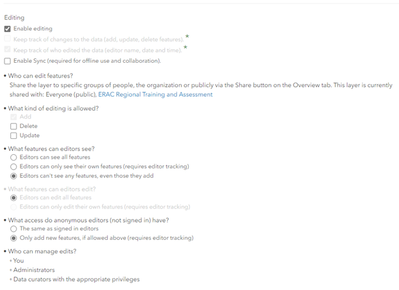

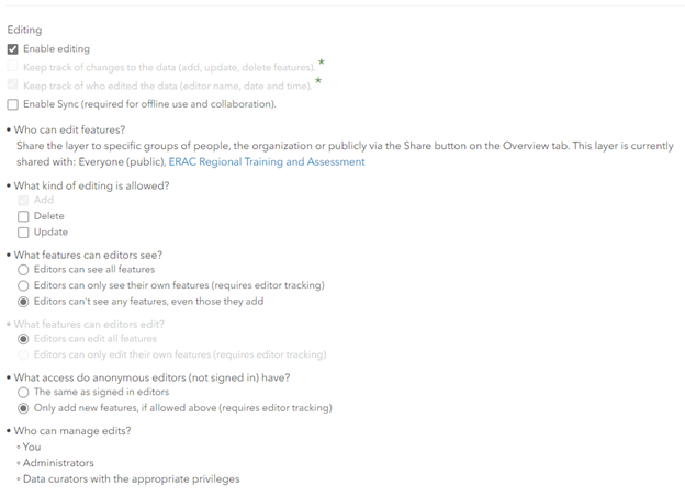

From the internal hosted feature layer, a view layer was created specifically for the attendance related table that only contained fields applicable to self-registration (i.e., name, email, etc.). The settings for this view layer enable anonymous users to only add new features and does not allow editors to see any features.
Additionally, the view layer has a filter set as another layer of security (more detail below).

After playing around with the REST services page using an external account, I tested a few things:
  • On the REST services page, as expected, features can be added to the layer which matches the settings (i.e., anonymous users can add new features).
  • I tested the update and delete operations as well and as expected, none of the features could be altered or deleted using JSON via the REST services page. This is good!
  • In a worst case, someone could theoretically run a loop and continuously add data to a public view layer where editing is enabled. However, that would require the user knows the unique ID of the view layer and takes the time to put that together.
  • If that does happen, editing can be prevented by turning off editing. Furthermore, the view layer can be deleted to prevent future submissions as the user would have obtained the item ID. Though it is possible, it does seem like an extreme case.
