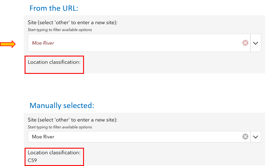

Hi,
I have a custom URL to launch a survey and pass the area of interest and site name. I have the same process for another survey and have no issues. In this case however, the AOI is passed without issue, but the site name comes across as red italic text. When i submit the survey this text is not written to the record in the hosted feature.
I am also using the site name for some pulldata functions that are not running. If i manually select the site name, it all works fine.
My question is; what does it mean when you get red italic text when using a custom URL (see below)? For example, I think blue text indicates a calculation.
Thanks, Jamie

Hi Jamie,
It means you have passed in an invalid value. I see as you are using a select one for this question, the value passed in via the URL is not a value in the choice list for that question. The value passed in needs to match the value in the name column of the choice, not the value in the label column.

JamieLambert
Thanks Phil!
The choice list was the clue i needed. The values in the list are fine (value passed matches the name field). I have a calculation that filters the choice list based on the type of inspection (routine, spot, etc.). I just need to update this to accommodate the changes I am currently making. When i remove this calculation it all works as expected. So my issue is with this and not the URL!
