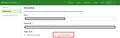

When working with webhooks, you need to ensure that you have manually checked off "Existing record edited"
If you don't check this option (manually), your survey submissions will only trigger from new submissions and not editing an existing form.

Hi, thanks for your response. Both boxes are checked in our webhook. Sorry for not making that clear in my post.
