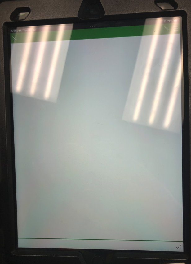

One of our field staff reported a crash on an iPad. I am still trying to collect details on the issue.
He said: "I had not closed the application but when I unlocked the iPad after 30 minutes of no use, Survey123 had to reopen (as if it had crashed or been closed). It then asks if I want to continue the in progress survey but takes me to the frozen page."
Has anyone else by chance seen this behaviour before? I've been able to leave S123 open on my iPhone for many hours in the past. I will try various things on iPad now and see if I can recreate.
