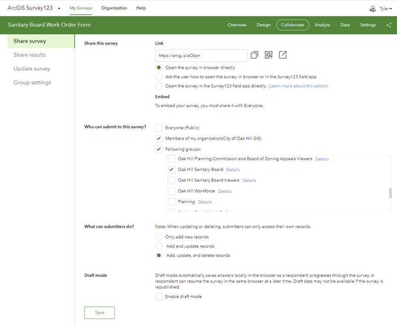

Here are my sharing settings for the survey:

And do those match the sharing settings for the feature service? It seems like a silly question, but the form item and the data layer can sometimes get mismatched.
