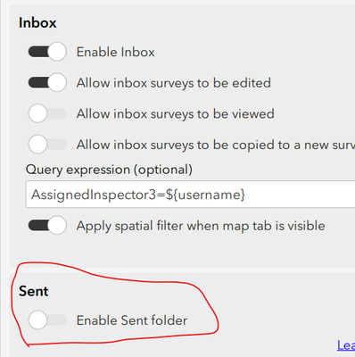

Here's what we do - We use the Inbox queried for "In Process," Then once each part is complete, the inspectors can submit.
Then have the team refresh the inbox when they need to grab the current "In Process" reports.
I you find this helpful.
Just a note that you'll want to turn off the sent folder when using the inbox. This query is set up to bring ONLY the logged in inspectors reports into his/her inbox.
