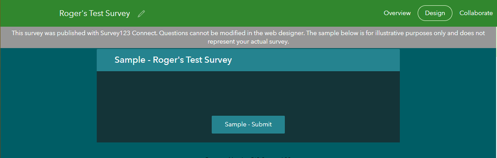

Ok, with that prodding, I've got the validation working. Email and Phone are now required only when Auto Accident is chosen. However, this has lead to another, possibly more annoying problem...
Now that the validation is working, I can no longer edit the survey in Survey123. Is there no happy medium here? I can't possibly be the only person who thinks designing a survey via Excel spreadsheet is crazy kludgy...

DougBrowning
MVP Esteemed Contributor
Nope it is one or the other.  This was just posted today take a look.   Once you get used to the excel it is much more powerful but for sure more of a programmers interface.
