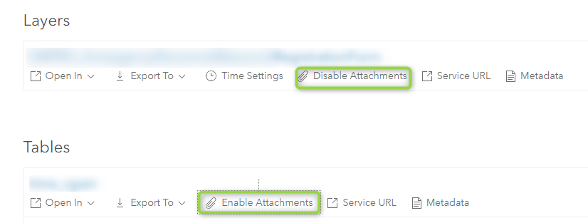

This is the original survey data setting. The main feature layer has attachments enabled, but not the related table (no attachment questions attached in this table).
In my join view layer, 'has attachments' is set to false, and I tried to update it to true using admin function, but it was not saved.
