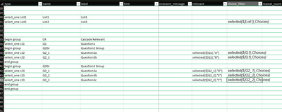

You might be able to achieve a reset effect but making question 2 relevant on question 1 and question 3 relevant on question 2.  That way if they reset question 1 it should clear out the answers for both 2 and 3.   However this would only work if they clear the entire question.
 A combination of relevancy, choice filters and additional questions may work.  You might have to add a few more questions to get the exact effect.  ie make a question for 2 with only answers from a choice in question 1, and also make it relevant on that answer being selected in question 1.  Make a series of these questions to  cover all options for question 1.

Edit:  Here's a quick example:

Not sure what you mean by conditioned.  If you choice filter then no they will not wipe.  If you mean relevant then yes they should.  No example came through on your post.
