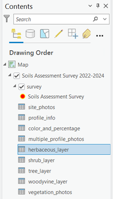

Hello! I am pretty new to ArcGIS and Survey123 and I have recently created a Survey123 form for some of our field work. The form has questions which only appear once as well as some repeating questions that will have multiple responses per submission. I have uploaded this data into ArcGIS and noticed that the data from the survey got divided into several tables (Figure 1).
Figure 1. Survey is the main table. Each table below was created from a repeating question in the survey.Figure 1. Survey is the main table. Each table below was created from a repeating question in the survey.

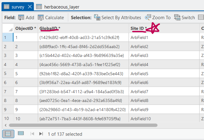

In the survey table, there is the SiteID, which is something I'd like to have appear in every table. It's connected to the GlobalID.

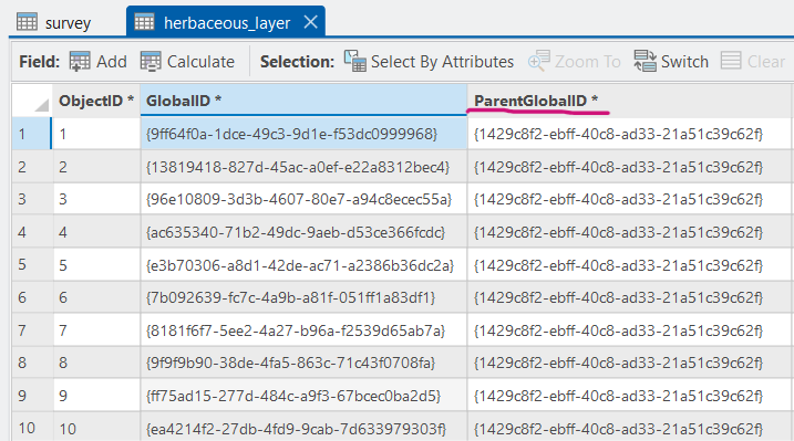

In one of the subsequent tables, the ParentGlobalID appears which is the same as the global ID in the survey table. I'm trying to have the SiteID column appear in all the tables that don't currently it and thought there would be a way to connect them through the GlobalID. However, in the other tables, all of the Global IDs are different.

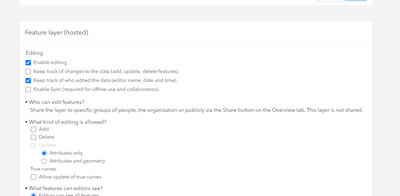

That said you should be able to join the two tables based on the GlobalID/ParentGlobalID relationship.  You may need to check the settings in ArcGIS online to ensure editing is enabled.

For editing the feature class in ArcGIS Pro, I believe you have to turn editing on in the setting, and yes the feature class that Survey123 is using to store the entries is on ArcGIS Online (or your Enterprise system).

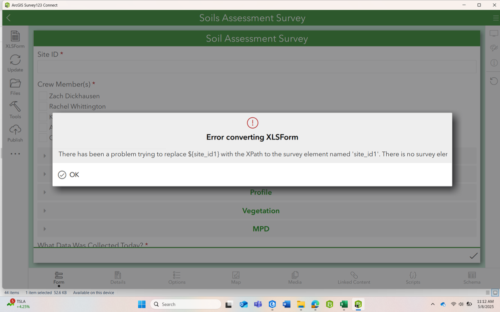

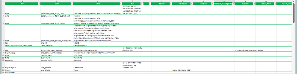

So, I entered ${SiteID_1} into the hidden field (body::esri::visible), and then in the calculation field, I entered ${SiteID_1} = ${SiteID} for each field that was a "begin repeat" type.
I ended up getting an error message saying that the survey element wasn't found. I also tried putting the hidden field and calculation fields within the repeat instead at the beginning of the repeat and that didn't work. I also checked ArcOnline and the editing is enabled.
I am not sure where to go from here. Any thoughts? I have also tried changing the capitalization of the "site_id" to match the survey element but I'm not sure if I did it right.
