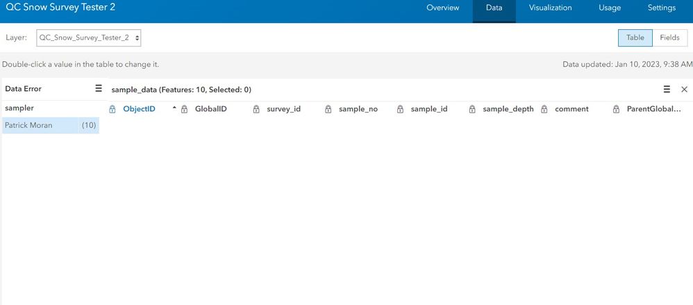

Thanks again. What's really curious about this is that the form had been working exactly as intended for several years. Nevertheless, I even went as far as to re-install Survey123Connect with the latest version and then rebuild this survey from scratch, this time taking out those nulls as you suggested. The result? Now the related records are not even showing at all. It's just blank. So maybe I have to ditch the repeat section altogether.

Mmm it says 10 there at the top.  Maybe it is security issues?
