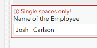

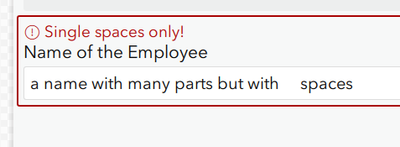

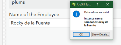

By using regex in the constraint column, you can get your survey to check for a single space.
In its simplest version, you can try ^\w+\b\s\w+$. This will match a first name and a last name, separated by a single space.
To get this expression to catch names with 3 or more (or even 1) parts, you can use grouping. The expression ^\w+(\b\s\w+)*$, which will look for 0 or more instances of words following the first. This will allow your form to take all kinds of names, while still ensuring that only single spaces occur between the various parts of the name.
- Josh Carlson
