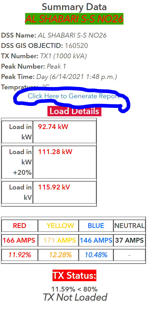

Basically, I have a survey and its results presented in the dashboard and  the users can click on the link to generate directly a report for the filtered feature and the link is like below:
https://survey123.arcgis.com/surveys/xxx/data?report=objectIds:selected;format:docx&filter=(0.dss_gi...
https://survey123.arcgis.com/surveys/xxx/data - this will open the data tab
?report=objectIds:selected;format:docx;templateItemId:xx - will open the feature report window in the lift of the page and select "selected records only" and chose format as .docx and chose the template.
Here I need to go deeply to name the report and unchecked "Save to my ArcGIS account"
then generate the report automatically.
