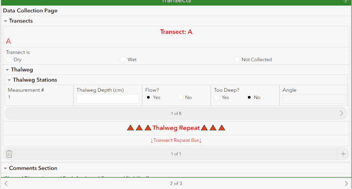

@SMDSAdministrador   This seems to have come back in the 3.17 update that just came out.  Can you test it again?
Here is mine breaking
