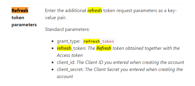

Hi,
Are you building your own webhook using HTTP and the OAuth authorization? Have you tried set refresh token in your webhook?
HTTP – Integromat Support
Token—ArcGIS REST API | ArcGIS for Developers
Thanks,
Ruth

Hi Ruth,
Thank you so much for your answer! No, I do not use outh2 authorization and do not know how to use it. Should i use sharing/rest? My rest service url is something like https://domain.org/server/rest/services/Hosted/service_421421421/FeatureServer/1/UpdateFeatures?toke...<token>. How can i modify it to use outh2 and refresh token feature?
