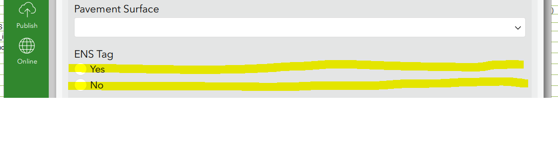

I am using Survey 123 Connect to create a field app that will replace an older system. During testing, a concern was brought up that I haven't been able to figure out on my own. They like using the default vertical select_one question types for Yes/No questions, but they don't like that Yes/No can be selected if they touch the screen anywhere horizontally adjacent to the choices. Is there a way to limit the choice selection to just when the circle to the left of the choice is touch/clicked on. I appreciate any help! Thanks!

 The only thing i can think off is using an .svg and the image map functionality
https://community.esri.com/groups/survey123/blog/2019/09/26/using-the-image-map-appearance-in-survey...
preparing the svg can be awkward but its useful once you get it to work and it works well . We use it for selecting body Parts that may have been injured so a simple yes/no image should be more straightforward
