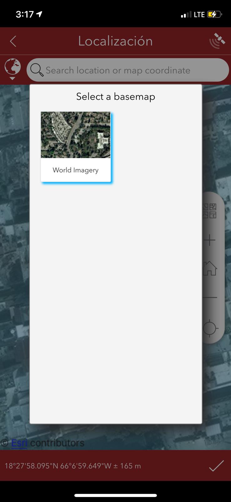

In version 3.11 we do not see basemaps, just one, imagery

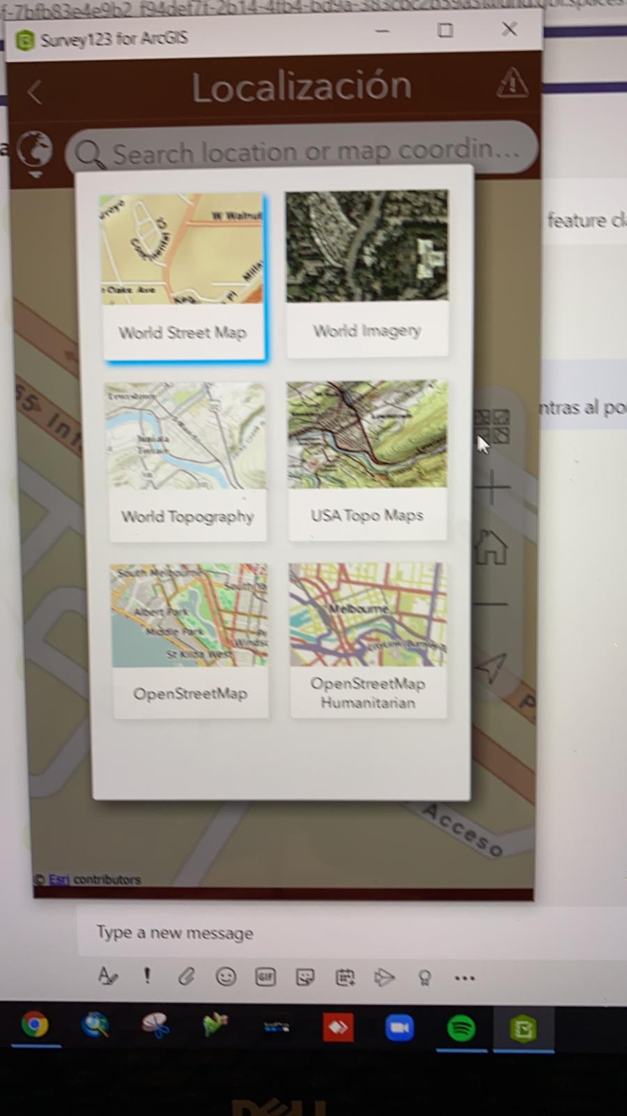

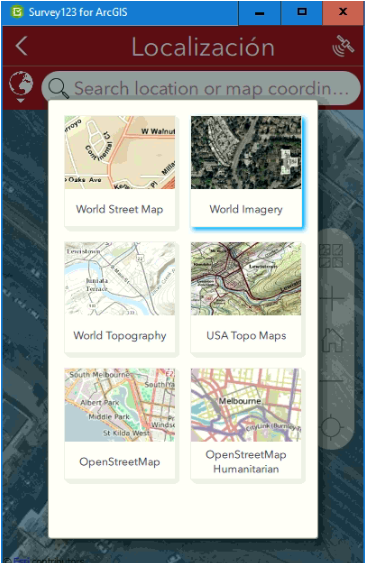

In version 3.7 i see more basemaps but I do not see hybrid imagery.
In version 3.6, like 3.7, i see more basemaps but not hybrid imagery

Hi @DiegoLlamasOlivares,
With version 3.11 (actually from 3.10 onwards), we now support Standard maps as default, and the Basic maps support is now off by default.
Standard maps uses the runtime and vector basemaps set in your Organisation by default, whereas Basic uses a predefined list of raster basemaps available in AGO or Enterprise organization.
Please refer to: https://doc.arcgis.com/en/survey123/desktop/create-surveys/includemap.htm#GUID-31B9C45D-8D07-4F0F-A3...
You can switch back to Basic map types in both Connect and the field app using the Settings menu, to see the older raster basemaps, otherwise make sure the Organization basemap group set in your AGO or Enterprise organization includes all the basemaps you want to see.
