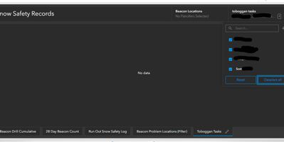

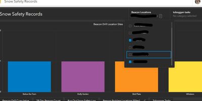

This is the table, displaying all of the tasks, performed by all of the patrollers
However when I go at try to create a category select, I choose the Patroller field from the Layer, there is nothing to associate it with in the table, so do I need to add the patroller to each table as well? I see the Parent GUID in the Table but no GUID in the layer, and I have tried to ensure it is selected..
I tried to work with what was there, selecting Patroller from the Layer, but there is no field that I can find to associate it with, I choose Toboggan but get NO DATA pop up..
But no data will display when I have the ACTION selected
It does work when the layer is alone and no Table is associated with it...

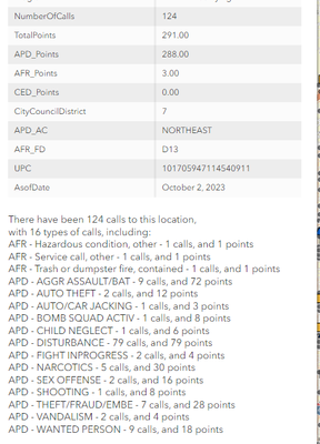

Being able to view related data such as those in repeats is challenging, simply because you are looking at multiple states of the same location. I think you need to clearly define how you want to be able to understand those repeated or related values. The screen shot below shows a pop up that I've enhanced by summarizing data in a related table - 124 records for a single address. There is almost no way you can show that kind of detail visually. This is accomplished using Arcade and a custom expression built for the pop up of the given feature layer.
