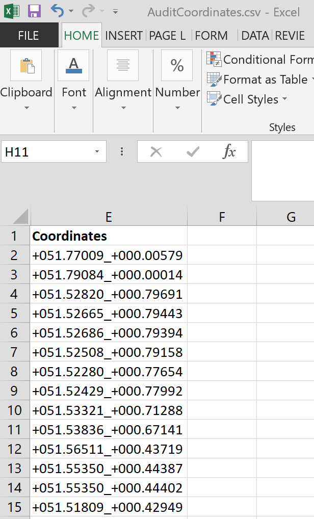

Similar questions have been asked before but I can't quite get the result I'm looking for.
I have a .csv with coordinate information in (what I think is) the correct format. It is saved in the media folder
I've tried using the Pulldata function in the Calculate field for the Geopoint question.
Is this correct or am I missing a step? Is it even possible? Perhaps it's just that I'm unsure of the correct syntax?
Any advice would be appreciated
Many thanks

Hi. Check this article: https://community.esri.com/t5/arcgis-survey123-blog/survey123-tricks-of-the-trade-working-with-uk-po...
You can create a cleaner csv keeping the latitude and longitude values separate. The calculations will be more straightforward that way too.
