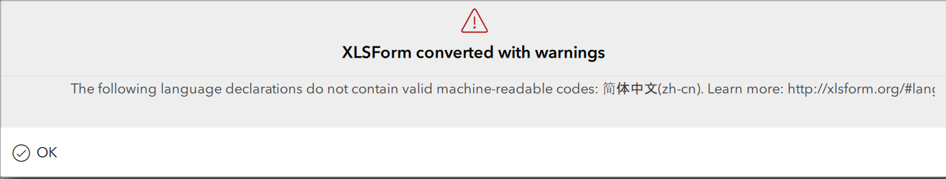

I referenced this page: https://doc.arcgis.com/en/survey123/get-started/systemrequirements.htm and the supported languages have different codes for Traditional and Simplified Chinese - (zh-hk) and (zh-cn) respectively. I tried adding (zh-cn) as the code for Simplified Chinese, but received this message:
I can use (zh)2 to publish, but whichever language receives that code shows the code when selecting a language on the live form.

`zh-cn` and `zh-hk` are the correct language codes, please see the Supported languages documentation for more information. The message returned is just a warning and comes from the library used to convert the XLSForm.
