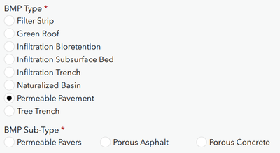

Hi @BryanO_Reilly,
What version of Survey123 Connect/field app are you using? I just tested with 3.12 release and 3.13 beta and both working fine for me using your xlsx file you provided above.
For example when I select the BMP type as "Permeable Pavement" I can see the 3 choices in BMP Sub-Type that relate to that choice filter.
Regards,
Phil.

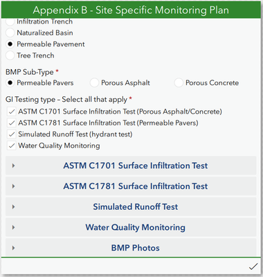

Hi @BryanO_Reilly,
I am a little confused, the select multiple for Perf_Test also appears to work correctly for me. If I select one of the choices in the Type question, I see the related choices in the GI testing type question. When I select those I see the groups that are relevant based on those selections. Am I missing something? Can you explain in more details or provide screenshots or video recording?
Regards,
Phil.
