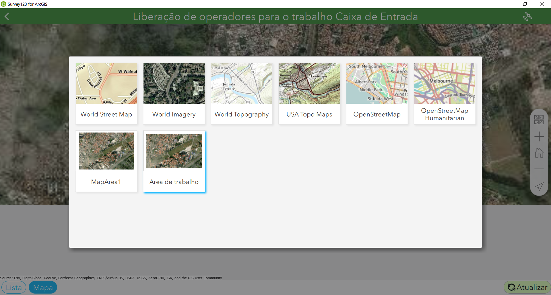

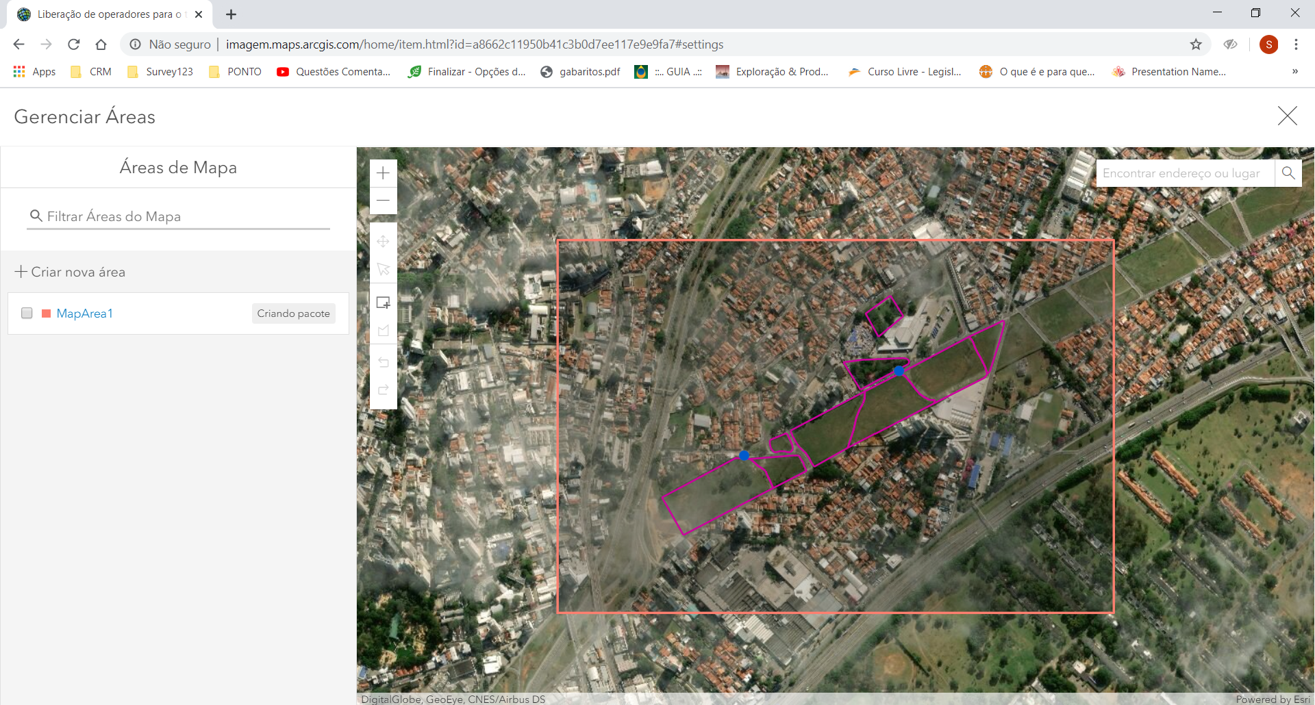

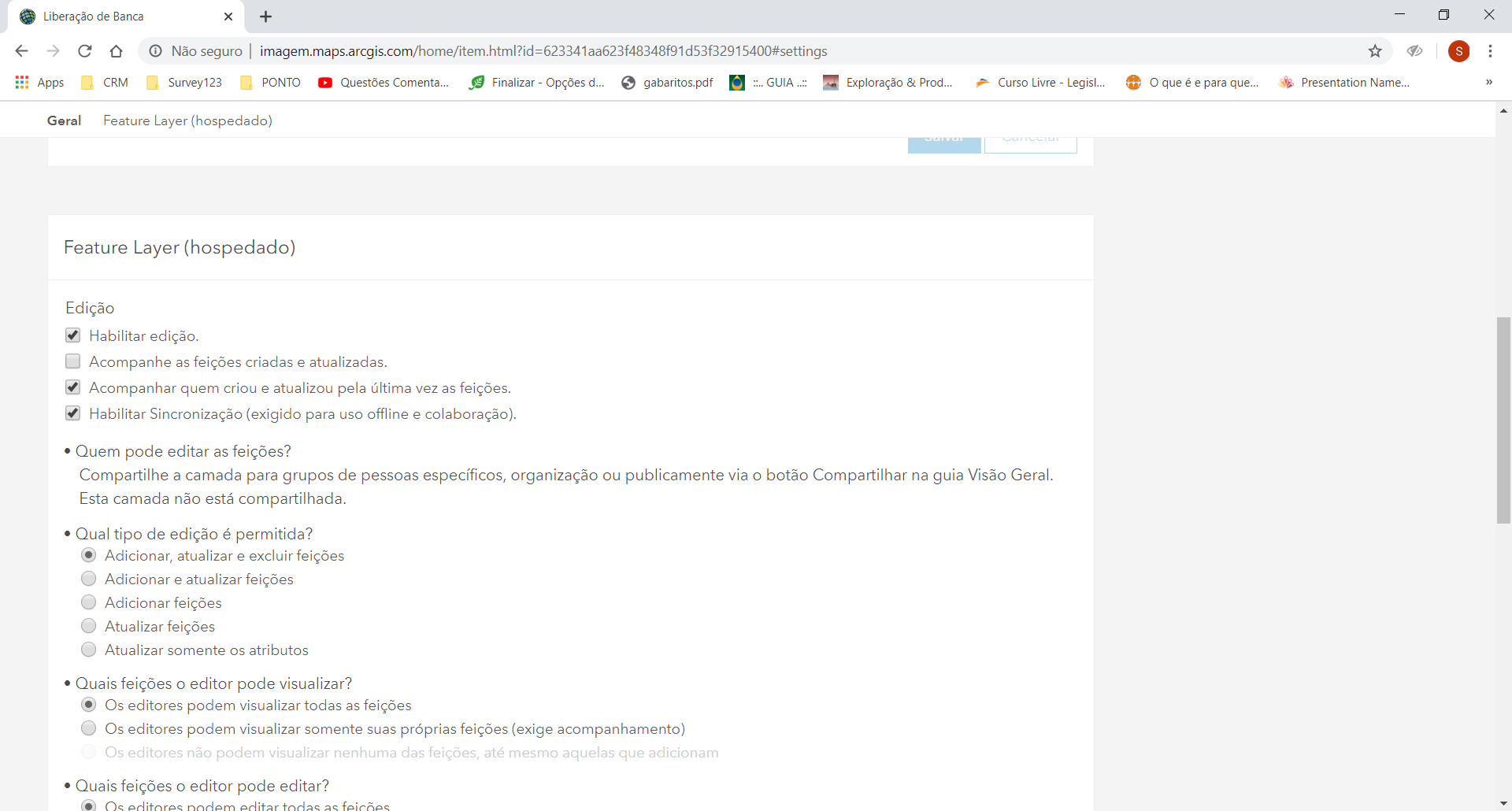

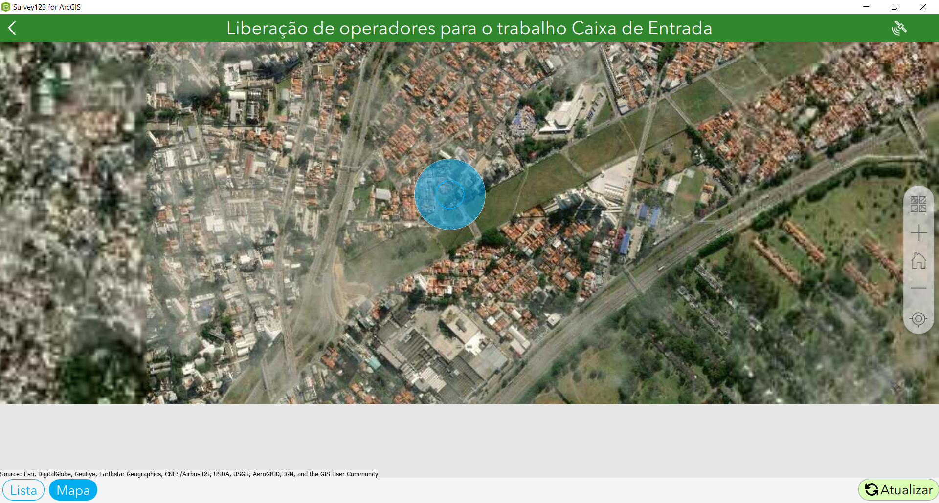

But, I have been  trying to use an offline webmap into survey 123 without success.  When I put some vectors inside this map (all with offline option activated as informed in documentations). These vectors don't charge into survey 123.

Feature layer:
Prints Survey:
Map without  layers previously configured:

Please have a look at the 'Create a map package in ArcGIS Online or ArcGIS Enterprise' section of this page:
Prepare basemaps for offline use—Survey123 for ArcGIS | Documentation
It says
Only the basemaps from a map area can be used in the Survey123 field app. Each basemap layer can be downloaded as a separate offline map package. Operational layers and labels in the map area are not be displayed.
I'm not sure whether we can include layers in the future but I don't think we can do it at the moment.

I read this doc, but the doc that I'm talking refers to offline map generated directly from ArcGIS online as you can see: Utilizar mapas da web offline—Ajuda do ArcGIS Online | Documentação
We are talking about different ways to produce offline maps.
In the documentation above have an item that allows you to put your layer offline and available to download.
If I read correctly all vectors in the web map are converted to a VTPK package, to download in Survey and other apps.
But it's not working like the documentation says.

Jing_Sun
Hi Bruno,
I think we are talking about the same method - create map area in AGOL.
And my understanding of the current limitation is, whatever what you have in the map package created in AGOL, Survey123 can only display the basemap layer.
