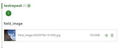

Hi Richard,
Thanks for the info! I included an image of the issue we are having for clarification. In the first record there is an image already attached. When the user goes in they can attach another image to that record. This makes it have 2 images in one record. Will the repeat_count fix this or just just limit the amount of records created?
Richard_Purkis
@dnykodym A repeat count will limit the number of repeats for that section.
The first image below shows the repeat count set to 1
This second image shows the options when the repeat count is removed. Notice the + icon is available to click
