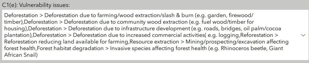

hi,
I want to see my selected choices separated by Bullet Points instead of Commas (Selected choices attached).
Any suggestion or hint will be greatly appreciated.
You could process the data within the survey but it depends on what and when you want to see the 'bullet list'. When do you want to see this? Within the survey? After submission but immediately? Where? A report, the Survey123 website, a web app, the downloaded data?
e.g. you could use JavaScript function within Survey123 form to process the comma-separated values from the multiple select question and return them as html driven bullet points. This would look OK in your survey form but then exporting to excel it'd be a mess of html tags.

Possible for this to show in the survey?

For a select_multiple, there is no way to change the display behaviour in the app. It will always be a comma separated list. You can always submit an idea to the Ideas area.
