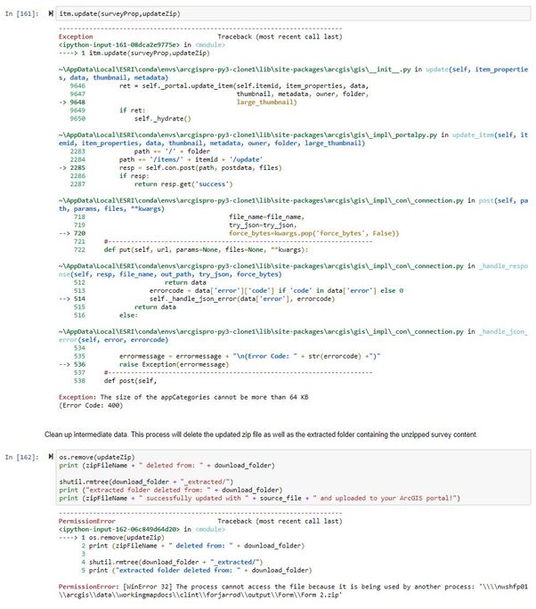

I was able to get the script to run however I ran into some odd behavior.  I am using connect and the mobile application.  The first time I ran the script without error it seemed to work as expected however after making additional changes to the update file the changes were not reflected in connect or the mobile application.  Connect and the mobile application continue to return the value from the first time I ran the script despite the new values showing the csv file in the media folder.  After reading through previous comments I realized I still had the survey linked to a copy of the csv file in AGOL.  I removed the link and tried running the script again but now get this error:

The script is failing on passing along the size of the survey properties to the .update method. If you replace the surveyProp variable from the first parameter of the .update method and replace it with an empty dictionary {}. That should resolve the error message.

ClintBoaz1
Hey Zachary,
That seems to have done the trick.  Thanks again!

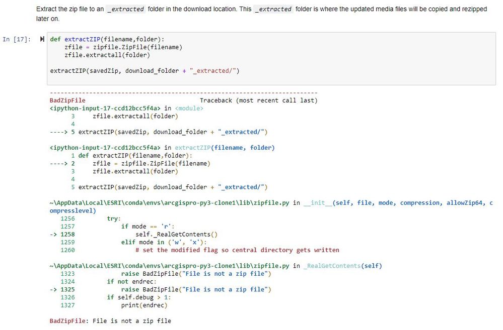

Thanks for pointing me in the right direction.  I am trying to run the script in a Jupyter notebook but keep getting the following error message
Any help would be appreciated, Thanks!

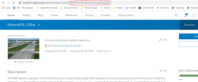

In the path specified for the `download_folder` variable, if you navigate to that path is there a zip file with the same name as your survey in that location?
If not please double check the ID specified for the `itemID` variable is the item ID for your survey form item.
For example:
You can also insert print statements in code block 4 to print the `itm` and `savedZip` variables which will show what item in your Organization will be downloaded, and where that item was downloaded to.
