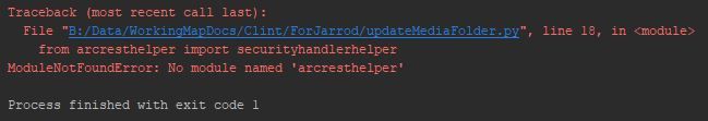

I apologize in advance if this has been covered in this thread already, I did search it and didn't find an answer.. I have a need to use this script and currently have 10.6 installed and the py2.7 version that comes with that. I installed pip and installed the arcrest package, I can import that fine, but can't import arcresthelper.. Tried a pip install arcresthelper and that didn't work. Suggestions? probably something simple I am missing here?
Thanks!
RDIApps

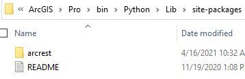

Found this thread: https://community.esri.com/thread/166523
Seems like my pip install arcrest did not work as intended? This is what my site-packages folder looks like..

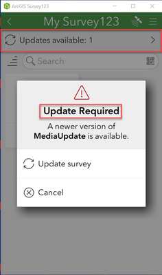

Also, with the new version of Survey123, you get an update notification next time you open the app. Once the script executes, the top of the screen on Survey123 will say "Updates available: 1" and you can tap that to refresh the survey! It is no longer necessary to delete/re-download the survey.

I am attempting to run the script but am getting the following error message despite having installed the arcrest module.
I am relatively new to python and am also confused by portal as I don't believe I have used or set up portal and was hoping to go the AGOL route as was mentioned in the explaination: "The script will connect to ArcGIS Online or Portal...upload it to ArcGIS Online or Portal".  Are there other edits that need to made to the script tp run through AGOL (like line 37 - "ArcGIS portal security type")/ what should be listed as the portal_url?
Could a portal/AGOL connection problem be causing this error?  When I look in my python folder I do not see the arcresthelper folder...  despite having done a pip arcrest install.
My user parameters:
# User Parameters
# ItemID of the Form item you want to update
itemID = "c2c2ab0e33aa4b518c4233bbed870c20"
# Local folder where the Form data will be downloaded (include a / at end of path)
download_folder = r"//nwshfp01/arcgis/data/workingmapdocs/clint/forjarrod/output/"
# Updated file name (ie MyList.csv)
updated_file = "SiteInventory_SQLTableDownloadTest.csv"
# Folder path of the updated file (include a / at end of path)
source_loc = r"//nwshfp01/arcgis/data/workingmapdocs/clint/forjarrod/output/"
# Address of your ArcGIS portal
portal_url = r"https://gdrcnw.maps.arcgis.com/home/index.html"
# ArcGIS user credentials to authenicate against the portal (case sensitive)
credentials = {'userName' : 'Cboaz_gdrc', 'passWord' : 'False55cape!'}
# ArcGIS portal security type (LDAP, NTLM, OAuth, Portal, PKI)
security_type = "Portal"
Any help would be greatly appreciated.  Also, thanks for writing and making this code available.  This is exactly the process I need to automate!
ZacharySutherby
Hello @ClintBoaz1
The Survey123 team has been working on updating the script to use Python 3 and the ArcGIS API for Python as that is the supported replacement for the arcrest module.
I have a copy of the updated script in another Esri Community comment that is intended to replace this script.
We are working on creating a central hub and documentation for a number of Python scripts the Survey123 has, but unfortunately isn't live just yet. Once that hub goes live we'll be updating the existing blog posts with the updated resources.
The updated script attached to the other Esri Community comment takes 6 variables. They are:
  • portalURL - The URL for your ArcGIS organization (in your case: https://gdrcnw.maps.arcgis.com)
  • username - Your ArcGIS organization username (ex. gisadmin)
  • password - You ArcGIS organization password (ex. gisadmin1)
  • itemID - The item ID for the ArcGIS Survey123 form item in your ArcGIS organization (in your case: c2c2ab0e33aa4b518c4233bbed870c20)
  • updated_files - The updated file name containing the extension (in your case: SiteInventory_SQLTableDownloadTest.csv)
  • source_loc - Folder directory where the updated file is located (in your case //nwshfp01/arcgis/data/workingmapdocs/clint/forjarrod/output/)
The script will need to be run either in Jupyter notebook which ships by default with ArcGIS Pro, or can be run directly in ArcGIS Online if you have notebooks enabled for your account.

Users of the field app will need to delete the survey from their gallery in the field app on the device, re-download the survey from the Download Surveys menu, open the survey and they will have access to the updated survey and associated media files
We are updating the media folder contents regularly (weekly if not daily in some instances), and so asking our users, many of whom are volunteers, to log in, delete the survey from the field app, and re-download it prior to every survey is an extra step they could do without. If there is a way to update regularly without the need to delete and re-download the form it would be very useful.
Many thanks,
Rob
ZacharySutherby
Hello @DataOfficer
That statement is no longer relevant, since the 3.9 release of ArcGIS Survey123 an update notification system was implemented. After the media folder is updated Survey123 will recognize that the form item has been updated and display a notification that an update is available.
In Survey123 Connect under the options you can enable "Require update to the latest version of this survey" so that when someone selects the survey they will need to update it before starting a survey.
Thank you,
Zach

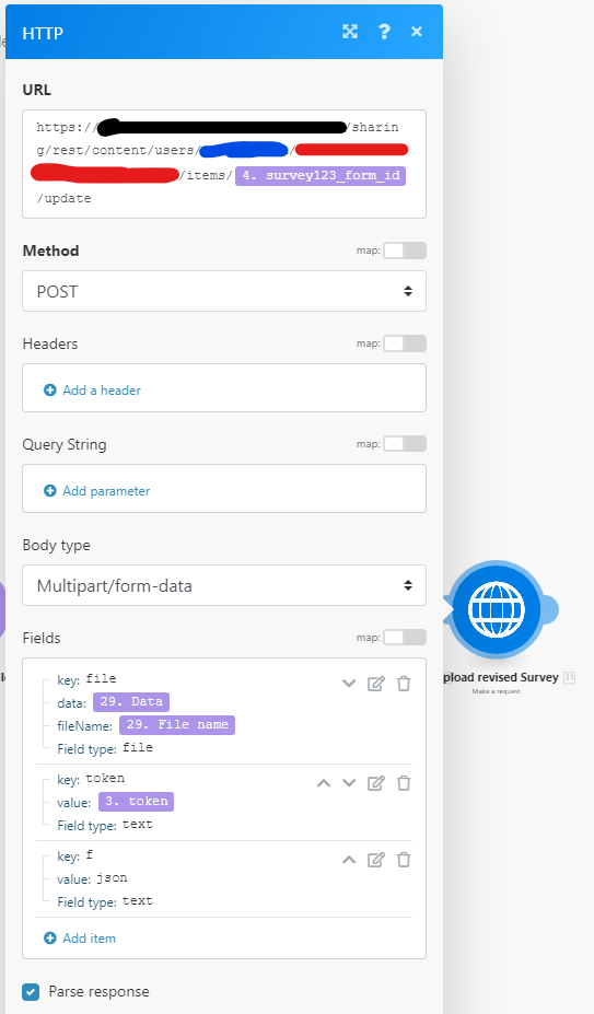

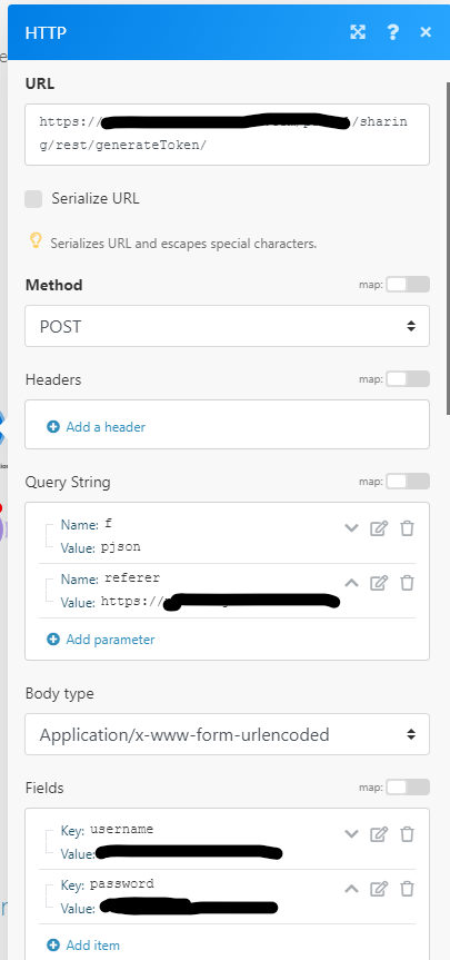

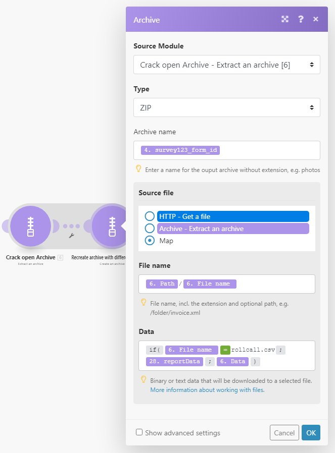

StrathconaBTS
I created an alternate way to do this with Portal/Enterprise without requiring a server or python. ESRI already works with Integromat. I was able to keep a CSV in the media folder updated by executing an Integromat scenario every day at a specific time. The CSV populates a select_multiple_from_file field. I used REST API calls to achieve this:
  1. Get your auth token - module: HTTP Make a request
  2. Download the survey zip - module: HTTP Get a file
  3. Swap in your CSV file - modules: Archive Extract an archive => Create an archive
  4. Upload the modified archive - module: HTTP Make a request
    RED is the folder ID the survey lives in
    BLUE is the user that owns the survey
