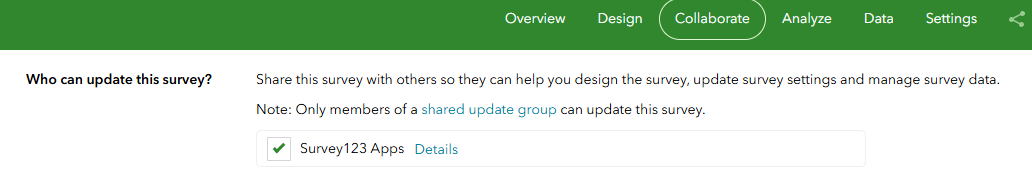

I was able to answer my own question - looks like Shared Update Capability is only available in the Survey123 Web Designer not Connect. Like you mentioned @RyanUthoff, best option is likely changing ownership of the Survey123 Form.Screenshot 2025-04-17 083513.png
