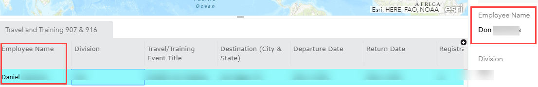

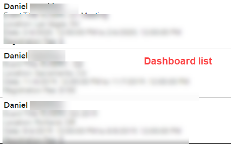

Is there a way to update feature layer without deleting data?  I created a survey and I am using that data to create a dashboard. I had an incorrect name (Daniel) and corrected the name in the survey to (Don), republished, etc. but the layer doesn't refresh and the name reverts to original name (Daniel) that was input in the first place. When republishing I noticed only the form is refreshing not the layer. I tried to put a dummy text field in the survey too and republished, downloaded, and got the same results. Please let me know if there is a solution to this or if I have to delete and start over with all. Here are some screen shots of survey website, files, dashboard results using feature layer as source.

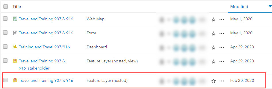

I created a new dashboard with the stakeholder view but when I start creating a list or another widget, the layer does not indicate that it is the stakeholder view. It seems to be stuck on the main feature layer
I have attached a couple of pics for you to reference. Thanks

1. Go to the org and open the main feature service with webmap viewer. Check the name in the attribute table. Does it show Daniel or Don?
2. Now open the stakeholder view layer in webmap viewer, does it show Daniel or Don?
3. If step 1 and step 2 showed different name, you might have the sync issue with the view and the main layer and the above article should resolve it when you unshare and reshare the survey.
4. Now check the dashboard and see if you can manually point the layer to the stakeholder view by click that "Change" button in Data options. Make sure step 2 shows the correct data first.
If you are still encountering the data sync issue, I would suggest you to contact Esri Tech Support and open a ticket to have the Tech Analyst to help you troubleshoot it further.
Thanks,
ElizabethHovsepian
Followed the above steps and both show Daniel in both the main feature and stakeholder tables in webmap viewer. So it seems there is a data sync issue.  I will reach out to esri support. Thanks very much.
