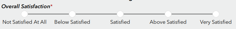

While taking a feedback survey for Esri support, I really liked the style used for the likert scale as each choice had a corresponding background colour for it:

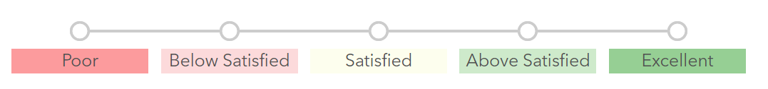

After publishing the survey and opening the webform version of it, voila - it worked!

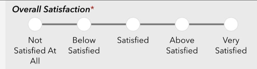

Now I was curious if it was just a S123 connect thing so I tried opening the same survey in the S123 app. No colours there.
