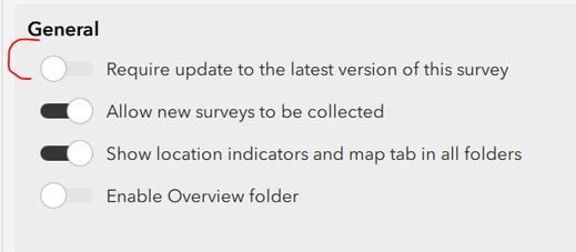

When the user selects the survey from the gallery it should notify them there is an update as well. To make the update required on the Survey123 website you can go to the survey, then settings, and select require update to the latest version of this survey and then save it.
You can also find this option in Survey123 Connect in the Options tab under General.

Do you have the setting set as posted above?  In Connect it is here

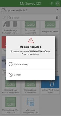

Which version of the mobile app are you running? And how are they opening their surveys? From the gallery or from a URL?
It should prompt them like this if you have that "Updates Required" checkbox on if they select it from the gallery, and it won't let them open it without updating. They won't need to pull down to check (it should also have the "Updates available" when the app loads, but it won't force them then)
