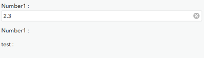

I am facing a problem with decimals, in my Survey123 project, the operator must enter a decimal number in a field. Later in the formular, the entered value is used in a calculation, but it doesn't work ! I tried to diplay the value in another field to see if there's a problem with it. It seems like when the value is an integer (e. g. "8"), there's no problem, but when a decimal value is entered (e. g. "3.2"), nothing happen, like if the value was not considered at all.

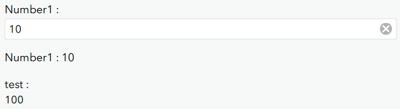

When the entered number is an integer, here "10", I am able to display the value and use it in a calculation :
When the entered number is a decimal, here "2.3", nothing happen :

Thank you for your answer ! I found a solution through your idea. I replaced the "type" from "decimal" to "text" then I can use the command number(...) to use the value as a number

Be aware doing it this way means the field will be stored as text which may be a pain later when using the data.
Inside the form 123 defaults to text esp on notes.  You can set the bind::type field to decimal and then it will work as you wanted.  If you want the database note to be decimal also you can also set the bind::esri:fieldType column.

I've wrestled with a similar issue where the focus doesn't seem to leave a decimal question (triggering the calculation) until something else forces it.  If you add a text question below your notes and click on it after you fill out the decimal question, does the calculation take place?
Strangely not all types of questions seem to make decimals lose focus, radio buttons don't work but checkboxes do, for example.
