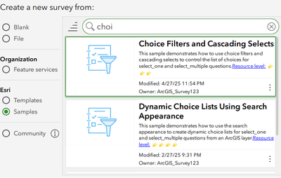

Sounds like you are looking for choice filters,  start by looking at this documentation. https://community.esri.com/t5/arcgis-survey123-blog/survey123-tricks-of-the-trade-choice-filters/ba-...
There are also samples in Connect
