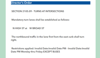

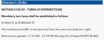

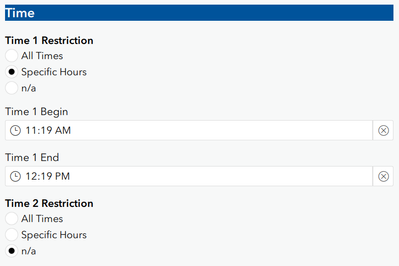

Time Fields in Survey123 Connect PreviewTime Fields in Survey123 Connect PreviewTime Output in Survey123 Connect Preview Director's Order SectionTime Output in Survey123 Connect Preview Director's Order Section
Invalid Date Error Showing in Published Survey for Same Times Shown in Survey123 Connect PreviewInvalid Date Error Showing in Published Survey for Same Times Shown in Survey123 Connect Preview
Time Fields in Survey123 Connect Excel DocumentTime Fields in Survey123 Connect Excel Document

@Neal_t_k Your response was helpful!  It is definitely an issue with how the time is handled when using the survey in a web browser versus using it in the Survey123 app on your phone or tablet.  Unfortunately changing it to dateTime didn't fix the issue as I still got the same Invalid Date error when using the survey in a web browser, regardless if I was using Chrome or Edge.  If they were going to use just the Survey123 app on their phone or tablet, this wouldn't be an issue, but since they will be mostly submitting via a web browser from their laptops, I used your second option of creating just a text question for the time using the mask and constraints.  Thanks again for the insight and help!
