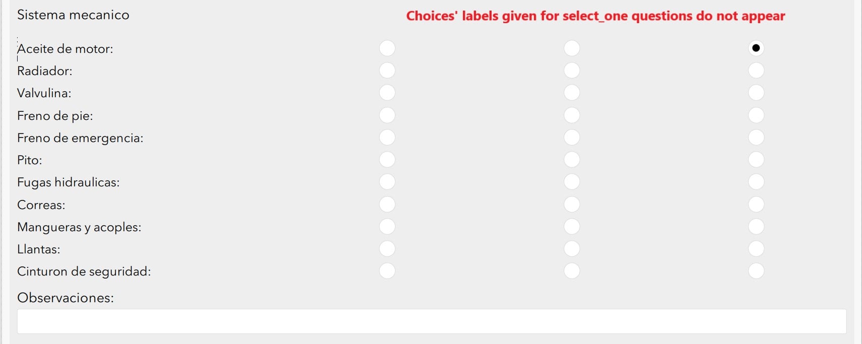

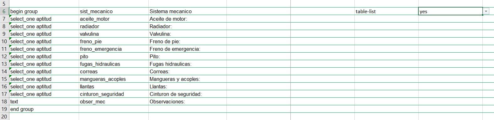

I am having some troubles in Survey123 Connect trying to design a matrix for select_one questions. I want to design a matrix for Y/N questions but those labels do not appear in the group questions. Here I send some picture of the problem.

 This is the group:
  These are the options given for those select_one questions:

Hi @MiguelSalamanca,
I believe this issue has been fixed in the 3.14 February update which was released today. Can you please update your Connect and field app version to 3.14 and let us know if any further issues.

MiguelSalamanca
You were right dear Philip. I've already updated to 3.14 and it's working as I wanted.
