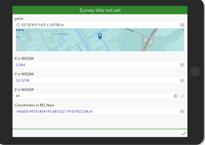

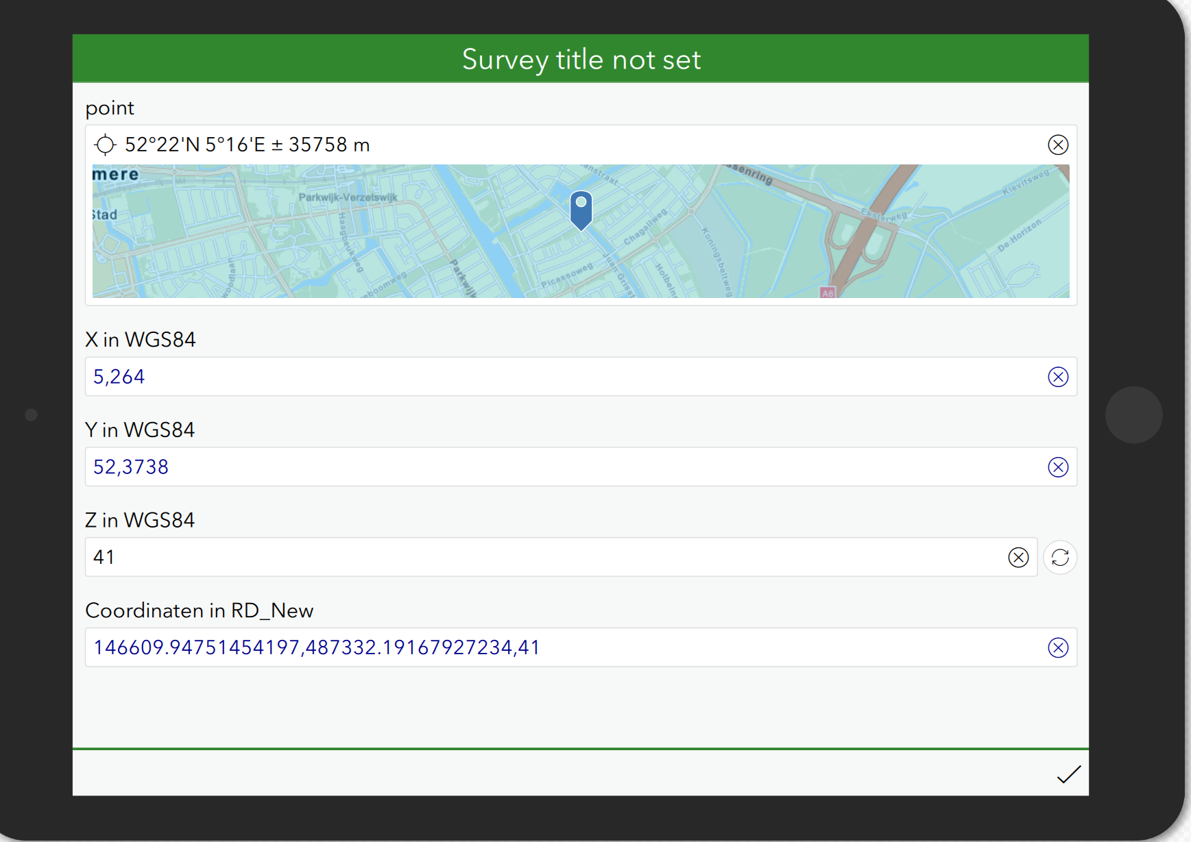

After building (npm run-script build) and placing the constructed JavaScript file in the survey123 scrips folder, i get the following results:
While x and y are correctly transformed, nothing is done with the z coordinates.
Is there a way to transform the z-coordinate too?
