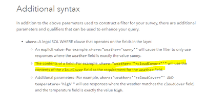

@DougBrowning You'll have to be more explicit about what techniques you're referring to. You're just tossing stuff into the wind.
The documentation you passed along is the same documentation I link in my post. I've read it and can't find what I need as this scenario isn't mentioned (or at least I think it's hard to tell if they're trying to mention it, but doing a poor job of it). Do you have a specific part you're referring to?
The highlighted section may be trying to speak to it but I don't think so. They don't really provide a clear example of how this works since they don't share the data structure they have in mind or the results of the example queries. I am guessing here that 'cloudCover' might have a value like 'overcast' and it's asking if the field 'weather' might have the same value, (where weather = 'overcast')? I don't really know.
