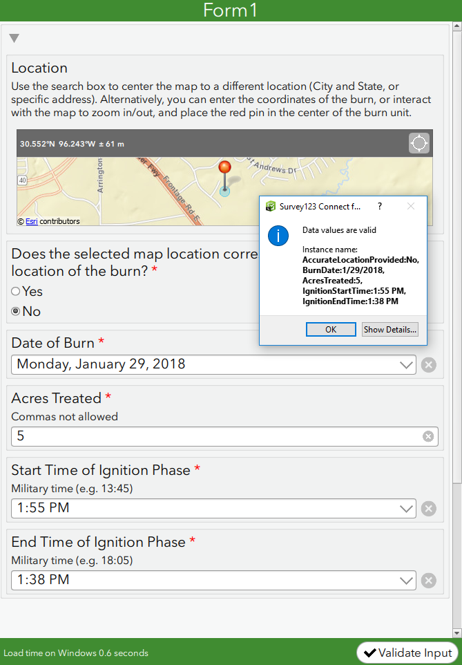

My form contains two time entries (start/end) and I have a constraint to prevent users from entering an end time that occurs prior to the start time.
This won't work neither in Survey123 Connect or the published form (includes web form).
Any advise will be highly appreciated.

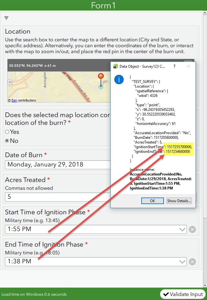

JAVIERVARA_SANZ
Thanks Phil.
Wouldn’t it make sense though, since Survey123 provides the option to create a time field, to automatically set the day of the epoch EPOCH value to the day the user is selecting the time of interest? There won’t be much value in the date at this point anyway, but probably a much better option. I seems to me that this field would have an important limitation if it doesn’t allow comparing values of the same field type, which is my case.
I understand the workflow around the star/end datetime, but believe these two values are automatically set by the application, so not a whole lot of flexibility here.
My other option is to remove the date field that I created to indicate the date of the burn and rely, as you suggest, on date time fields, although it would be redundant and a little cumbersome for the user, since the date is almost always prior to current, sometimes a few months back.
