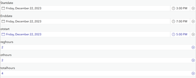

Example: Start time 3:00 PM End Time: 7:00 PM
Regular Hours: 2 Hours (Since end of schedule is 5pm)
OT Hours: 2 Hours (Since OT starts of 5pm).

I think the easiest way to do this in the form would be to include a dateTime field indicating the start of OT. The today() function sets the time to noon, so we can add 5 hours to that to get the OT start time of 5 pm.
date-time(decimal-date-time(today()) +  0.2083334)
Then we can use this date field to calculate our regular hours.
round(((decimal-date-time(${otstart}) - decimal-date-time(${startdate})) * 24),2)
And also our OT hours.
round(((decimal-date-time(${enddate}) - decimal-date-time(${otstart})) * 24),2)
- Jen

Jen: Thank You!! Looks like you are understanding exactly what I am trying to accomplish. I was able to take your example and build a test and it does exactly as you illustrated.
