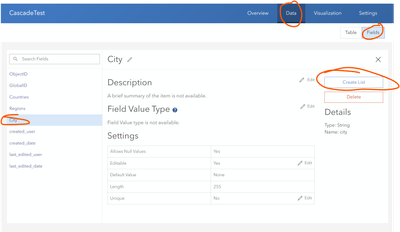

I'm using the latest version of Connect and can replicate the same behavior in 11.2. I'm assuming this behavior is by design, although it doesn't quite make sense because the question type in S123 is the exact same and should honor the domain. One possible reason for this is because S123 has the functionality to "filter" the domain by using cascading choices. Hosted feature services in Portal don't have that functionality, therefore everything will be visible even if it's not a "possible" value based on the cascading choice. And maybe Esri is being overly cautious and just doesn't apply the domain at all? I'm not sure.
Regardless, there is one workaround that I know of that you can implement. Manually add the domain to the hosted feature service in Portal. Unfortunately, it would mean maintaining a domain in two different places (S123 and the hosted feature service), but at least you would be able to have a domain in the hosted feature service to reduce human error.
