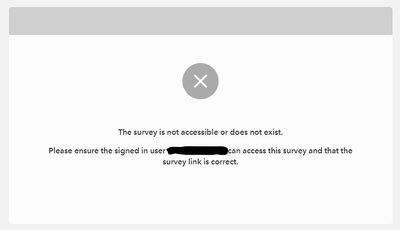

Hi, after the last update received in Survey123 connect (3.14.256), several Survey form's item details are not accessible in our organization. Please see the screenshot below.

Hello,
I had this pop up yesterday with two surveys. After some troubleshooting, I found a bug: A group with table-list appearance AND a non-select_one/select_multiple question (e.g., a note or text) as the first element inside that table-list causes the survey to give this error. The survey is still visible and accessible in Portal (and I would assume AGO).
This bug has been logged with Esri, and a fix will (presumably) be worked on and deployed sometime in the future.
EDIT: For clarification, this comment is in response to another more recent comment. The original reason this particular thread was started was for a different bug which has long since been resolved. However, the error message is generic, so there are many reasons why you could be seeing "The survey is not accessible or does not exist."
EDIT2: Logged as BUG-000160874

JChinn
Same issue is popping up in 3.18.
BUG-00160874 offers the following workaround.
·       Move the note or text question below the select_one question.
·       Change the appearance of the begin group question to compact, field-list, or leave appearance as blank.
See Esri's Technical Support page:
